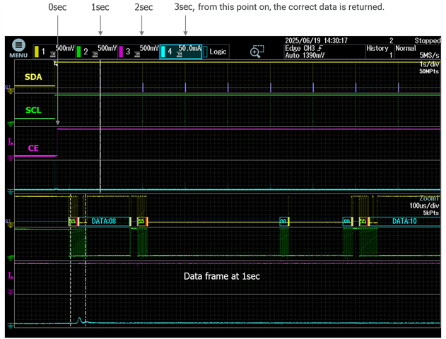

  • Please provide a scope screenshot that shows when the CE pin is enabled and when the gauge starts ACK'ing data on the bus.
  • Hi Dominik,
    Would the following screenshot be okay?
    Masashi

  • There are several times:
    1. Time until the gauge ACKs. This is what you show in the screenshot. At this time, the firmware is up and running fully. This means that the embedded CPU booted up and that it's ready to communicate.
    2. After #1, the gauge needs to acquire data. This runs on a 1 second measurement cycle. Therefore the measurements will not be meaningful until at least 1 second expired after #1. The gauge will report accurate measurement: Current, voltage and temperature 1 second after #1.
    3. After #2, the gauge algorithm needs to run a discharge simulation using the reference point that it established with the measurements from #2. The gauge will complete this after N seconds if the measurements aren't stable - it will require that the reference point (depth of discharge) doesn't change significantly. N depends on how stable the measurements are. If you have a load that causes voltage swings above a few mV then this may take several seconds. You will read correct measurements during this time.
  • Hello Dominik,
    Thanks for your confirmation.
    We also checked "A.1.3 OCV Timing" in the TRM.
    bq27520-G4 Technical Reference Manual
    We understood that being able to read correct data 3 seconds after POR ( = CE goes 'H') is generally correct.
    We understand that there is a difference in N, but is there a way for the gauge IC to know when the correct data is set?
    Masashi
  • Yes, you can read 2.1.1 CONTROL_STATUS and check bit INITCOMP. This bit will turn 1 when data is accurate.
