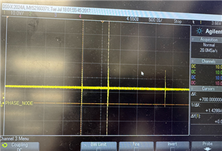

Wanna consult you , how to avoid oscillation when setting brightness 0 per register writing ? It will have bad impacts to touch . Either SW or HW adaptions are welcome .

Not clear for the question, so customer change the brightness of all the channel to 0 and see this waveform?
Any impact here, it looks device is worked as PFM mode.
Hi Zhiqian,

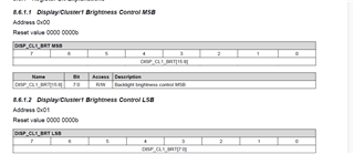

Yes, the customer adjusted the following registers 0x0 and 0x1. I understand that it is probably in light load mode. Is this ringing under light load normal? The customer is currently worried that this phenomenon will affect the use of Touch.
Hi, Alan
I am not familiar with the touch system. But for the PFM performance, I think it is a normal operation.
Hi, Alan
If you want to keep boost working with zero brightness, you will see the PFM mode.
