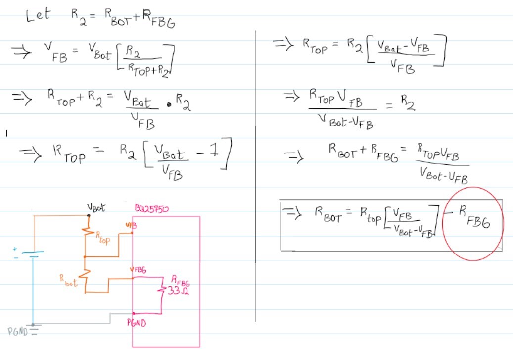

    My concern now is regarding the accuracy of the monitored voltage for the Battery Cells. If the voltage divider is effectively only monitoring P+ with respect to ground, and the BMS is actually placed in series with the cells, then the overall voltage being monitored is that of the cells + the voltage drop across the BMS. Surely the drop within the electronics of the BMS wouldn't be significant (considering my load wouldn't exceed 3A at this stage of the design); nevertheless it's a variation from the real voltage across the cells themselves. Your insights would be appreciated on how to mitigate this loss of accuracy.

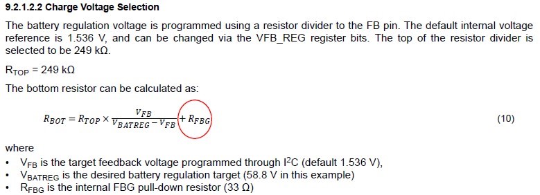

    On another note, please refer to my calculations below for Rbot, which show that the equation for Rbot should have -RFBG rather than +RFBG as represented in the datasheet. If confirmed from your side, kindly see to it that the datasheet is revised with an update for everyone's future benefit. Thanks.
    Datasheet Extract:
    Yes, this is correct. I'm working on updating this in the datasheet.
