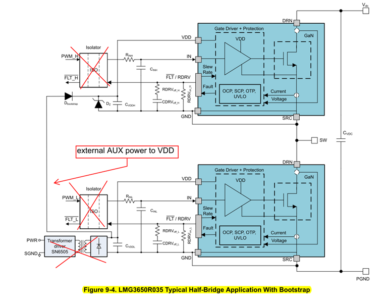

I would like to use this IC to design HB LLC with GAN ,the Fsw should be 200kHz~300kHz.
The power supply is for audio amplifier , input range: 200Vdc~ 380Vdc , 320Vdc nominal and output +/-63V, max 1000W
Please check if UCC25661 can driver GAN directly. If not , please proivde your advise.
Thanks!
  • Hi John,
    Yes we are a few reference designs in the works showing the UCC25661 with TI GaN.
    The first that might get published is a 240W adapter focused design with our LMG3614. For this power level, you might want to look at the LMG3650.
    I hope this answers your question.
  •  Hi JCHK,
    Can you describe your reference design about  UCC25661 to driver TI GAN ?
    I refer to LMG3650 typical Half-Bridge Application With Bootstrap in the datasheet .
    If I modify the driver circuit to connect UCC25661 directly as attached picture , do you think it is workable?
    Thank you for your help!
  • Hi John,
    That looks about right, I am looping in our GaN team to comment further.
