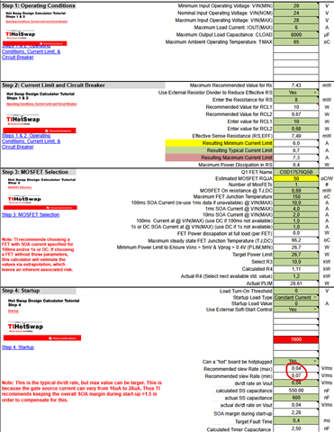

TPS2490: MAX slewrate is lower than MIN slewrate
Part Number: TPS2490
Other Parts Discussed in Thread: CSD17570Q5B
We use TPS2490 to power on a 10mF load. I have used the design calculator, but I get that the minimum slewrate is higher than the max slewrate. Does this mean I can not used the said part to power on my load. Attached is the calculator screenshot.
