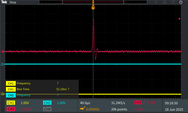

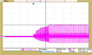

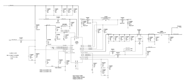

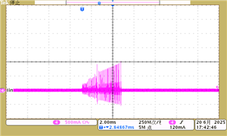

When I turn on TPS55289 output by set register 06 to 0xA0. it will pull a lot of current (peak 3A) from Vin and cause my Vin to sag. Why it is pulling so much current even I don't have big load. my output cap is about 100uF.
Is there way to reduce the in-rush current?
