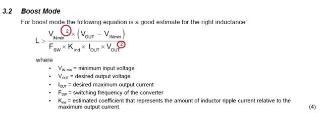

Today I read an AN called Basic Calculations of a 4 Switch Buck-Boost Power Stage , i don't find Fsw value in Appendix A (Design Example). Please check and provide,thanks.
tks, Please help
1. Provide the link of this datasheeet. Additionally, the reference SLVA372B was not found on the official website. Could you help provide it?
2. In Formula 4 of 3.2Boot Mode in this literature, the normal calculation does not include the square term. Could you help explain and illustrate the derivation process?

I do not see the formula you mentioned, please share a screenshot.
