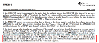

In LM5050-2 datasheet page.12, TI said the MOSFET with 47nF of effective gate capacitance.

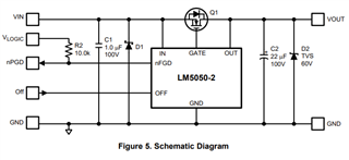

But I don't see any gate capacitance in LM5050-2 EVB user guide.
Is 47nF gate capacitance necessary?
Without gate capacitance, what's the tgate(off) spec?
