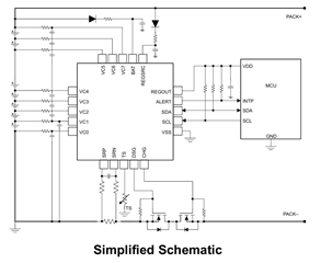

I was just checking if I need any reverse polarity protection for PACK?
In my understanding if reverse voltage is applied pack for charging MOSFET won't turn ON as AFE doesn't have supply due to BAT pin diode reverse bias.
Should I add reverse polarity protection?
TVS Diode across pack can work as protection?
