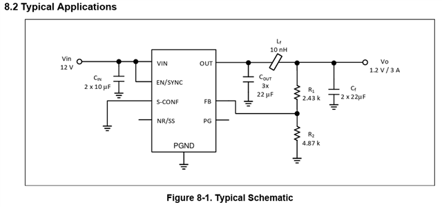

TPSM82912: TPSM82912
Part Number: TPSM82912
This screenshot is from TPSM82912RDUR power IC.
Which one is more correct
1) Placing feedback resistors after filter network
2) Placing feedback resistors before feedback network
I think in the below case, it is more appropriate to place feed back resistor after Cf(2x22uF) capacitors.
What are your opinions about that?
