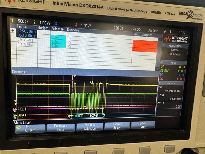

I use the BQ77908A, when I try to communicate with the component using the USB interface adapter probe and the software bq77908: bq78910 evaluation v2.3.0.0, I do not detect the component.
The address isn't always detected and if it is detected, it is the data who isn't detected.

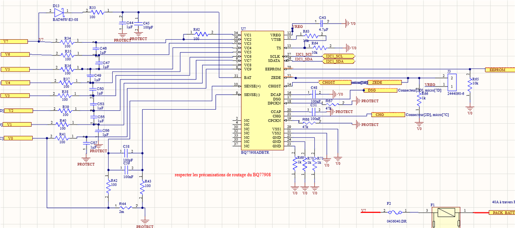

The schema is
I have CHGST to 3.3V and ZEDE connected to VREG.
And I have this I2C communication:
Yellow : SDA, Green : SCL and purple: EEPROM
