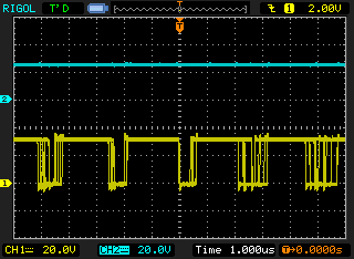

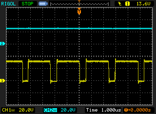

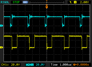

    sorry - was assuming that the device is set to PSM mode based on the pull down on the MODE pin in the schematic.
    Do you have the option to probe the inductor current and the signals on SW1 and SW2?
     Stefan
  • I don't have a current probe; so I am not sure how to measure the inductor current.  But here are the switching nodes for the low power and the high power modes.  Trace 1 = SW1, Trace 2 = SW2
    Note: Both modes are with no load.
    Low Power Mode
    Low Power Mode
    High Power Mode
  • Hi Paul,
    can you set the trigger edge to the falling edge for the low power plot.
    As you can already see from the plots, the device in one condition is in Buck mode and in the other in BuckBoost.
    Stefan
  • It is set to the falling edge of trace 1 (SW1).  Do you want me to set it to the falling edge of Trace 2 (SW2)?
    I do see that the trigger level is poor.  I will recapture with a better trigger level.
  • Why would it go into buck-boost mode?  The input is 30V and the output is 24V.  And why would it stay in that mode?
