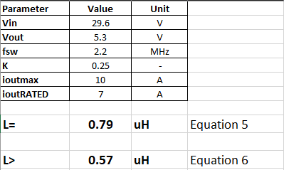

I am currently in the process of designing a buck converter using LM61495 to step down my 8s Li-ion pack voltage from 29.6V to 5.3V. The rated current is around 2A and the peak current is about 7A. I will assume a 10A of max current so we have some safety margin.
Then, I put my requirements into the TI Power Designer to get some initial ideas and I was recommended the following topology where a 560nH output inductor was used:

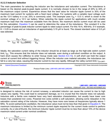

I then double-checked the datasheet of LM61495 and encountered equations 5 and 6 which are both used to determine the required output inductance.
Assuming Fsw = 2.21MHz, K = 0.3 and Imax = 10A, we get L ~= 660nH using Equation 5. If we use  K =0.25, then it becomes 790nH.
However, my typical current draw is about 2A which means I would need a inductance of 2uH based on eqn 6. Given there is a such large discrepancy, which equation should i use to find my required output inductance?
Thank you so much in advance!
  • Hi Robin,
    The inductor is selected based on the max rated current of your design. In your case that will be 10A (or 7A).

    I am well aware that I need to pick an inductor based the max rated current of my circuit but I also need to know what inductance I need for my circuit. Eqns 5 and 6 are giving me conflicting results. The post you referenced mentioned that, "Usually for current mode control devices, subharmonic oscillation happens when steady state operation duty cycle is above 50%." Does that mean I can ignore eqn 6 and only use eqn 5 to determine my required inductance since my application will be stepping down from 24V~34V to 5V, which will have a duty cycle less than 50%?

  • Hi Robin,
    Yes.
    For your use case -
    As mentioned earlier, please use the design calculator - it shall make things simpler for you.
