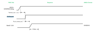

    Are you able to capture the timing of VSYS and the EN/PB/VSENSE pins going high on an oscilloscope?
    EN needs to be high within 120 us of VSYS for a valid on-request to go through.

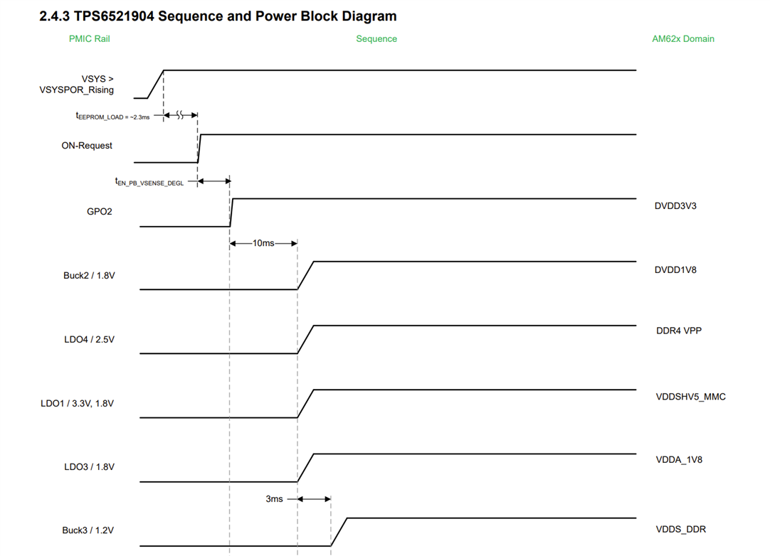

    In the power-up sequencing diagram attached, the tEEPROM_LOAD indicates the amount of time required for the PMIC to read its memory and load the EEPROM registers upon initializing. The remainder of the power-up sequence can only be executed after the EEPROM is loaded.

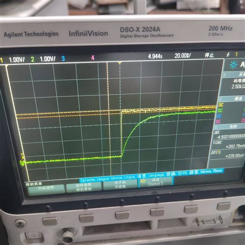

    As a follow-up to the failed rail output voltages, could you please provide oscilloscope readings of the VSYS and EN/PB/VSENSE going high? Also, I would like to analyze how the TPS65219 is powering up. If the power-up sequence is interrupted, the TPS65219 will attempt to power up two more times before remaining in the initialize state. Could you also provide scope readings of the output rails during the power-up sequence?
    Matt
  • Yellow is VSYS and green is EN.
    Pulling up EN is 100K.
    The VDD1P8 has an output of 1.8V, while the rest of the LDO and BUCK have no output.
    Thank you for providing an oscilloscope shot! Yes, it appears the EN/PB/VSENSE pin is in the enable mode and is powering up normally.

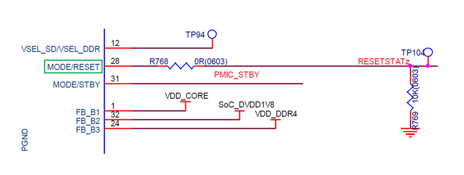

    Upon closer review of the schematic, is there any reason why RESETSTATz is pulled to GND at TP122? I would recommend pulling this high and checking if the rails provide any output.

    My problem has not been resolved yet. We have re-welded the small board (only the electrical and soft parts). The schematic diagram is as follows. It still doesn't work. I hope you can point out the problems in the schematic diagram.4251.PAGE2.pdf
    I'm sorry to hear your issues is not yet resolved. Thank you for providing an updated schematic!
    For the MODE/RESET Pin (28), please try pulling this pin high and verify if the rails provide any voltage output.
    Matt
  • It has been tested, but there is still no output
