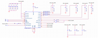

  • Currently, I have obtained this PMIC and want to verify its output. However, upon actual measurement, it was found that when using this circuit for verification, the PMIC did not output anything. Only VPP1P8 had a voltage of 1.78V, while the other LX and LDO did not output anything. Is there a problem with this verification circuit? Could you please provide the simplest verification circuit? Thank you!
  • Hi Junzhi,
    I do not notice any issues with the schematic. VDD1P8 showing 1.78 is a sign that PMIC is being powered on correctly.
    The schematic in the TPS65214EVM user guide can be used as reference for verification circuit.
    Are you able to capture the startup signals of VIN signal, EN, GPO, and BUCK2 pin on oscilloscope, if possible?

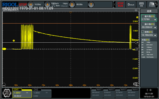

  • Currently, we are only conducting pure hardware verification and there is no connection to the SOC. The I2C signal has only been pulled up, and it has not been connected to the AM62Lx or any other SOC. The output waveform of BUCK1 is as follows and it is constantly adjusting in a loop.
    BUCK2 and BUCK3 will not adjust again after stabilization. For example, the waveform of BUCK3 is as follows.
  • Hi Junzhi,
    Thank you for sharing the waveforms. It may be harder to understand the problem without I2C readings, so I may have some more questions.
    This initial oscillation is not normal for any of the outputs. The output should immediately be stable for BUCK2, BUCK3 .
    Can you also share waveform for VSYS input, to see if it is noisy?
    The outputs look to be picking up some higher voltage up to 2.8 V.
    Are you able to share the layout? This can be shared over our email thread, if necessary.
