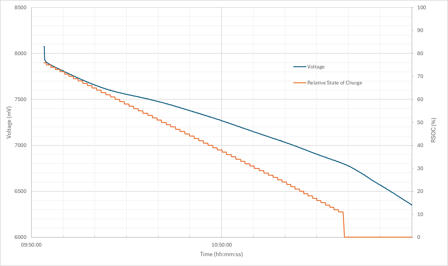

  • Sadly setting the Term Voltage didn't quite do what I was hoping for. While the voltage threshold that I set did end up being 0%, it drops 11% in the last 25 seconds. I have uploaded the log with more parameters if it helps
    Batt_log.log
  • This means that the gauge over-estimated capacity. This is either due to:
    * Incorrect Qmax
    * Incorrect resistance table
    * Incorrect load prediction
    * Incompatible ChemID
    and various more obscure less likely reasons.
    Please make sure that Qmax and Ra are correct (run a true Learning Cycle). Also check that Load Select and Load Mode are correct.
