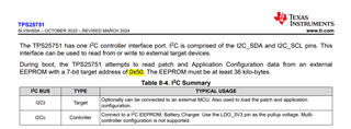

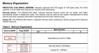

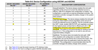

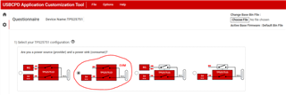

According to the hardware description, I can't deceive the 12V PD protocol of this TPS25751D at present.  I downloaded the bin file generated by USBCPD_Application_Customization_Tool 1.1.0 to the corresponding EEPROM, and it can also be read through the USB-to-I2C tool.  Has this BIN file been used correctly?  How to handle this configuration?  I did burn this bin into the eeprom.  What could be the problem and how should it be solved?
This is a bin file I generated and it needs to be extracted below
