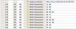

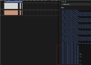

I am also attaching the I2C packet capture from the logic analyzer taken after the patch download was completed.
Thank you for your support.

    • Make sure the PD controller enters APP mode. (seems fine from what you have said so far, but just ensure it is)
    • Capture I2C between the PD in the following situations
      • Right after patching the TPS25751
      • During the type-c connection to the USB Port
    • Do you have a PD analyzer? A tool that captures and decodes the CC line communication. If you do have one, collect logs on the connection event.
    A typo on my part, but could you capture the I2C between the PD controller and the BQ device during the two situations mentioned above? We should expect to see some I2C writes from the PD controller to the BQ device that configure certain operational modes during these two states. I need to confirm if they are happening or not.
    I tested your json on the CHG-EVM, and it seems to be working properly. I was able to see precharge(.119-A) and charge current(1-A) being drawn when a Type-C PD source was attached at the port. I tested using both a 4 quadrant supply (battery emulator) and a Constant voltage e-load, both seem to work fine. Here is what we are expecting to see in the logs I am asking you to capture.
    Is your battery attached to the Bat ports during this time?
    Initial power up:
    Some configuration of the BQ, some writes that are easy to verify are ones regarding the charging currents. These should match the config settings. It is also important that the watchdog timer gets disabled during this step. Ignore the large burst at the beginning and the writes to 0x50. This is just the Device booting from the EEPROM.
    Source is connected:
    CHG mode should be enabled
    INDPM and VINDPM should be programmed to values that reflect the negotiated PD contract (this is not easy to verify without a PD analyzer, but you should at least see writes to these registers).

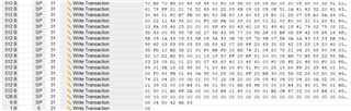

    The easiest way to confirm the patch burst process occurs properly is to read some PD controller registers to see if they match what has been set. A common recommendation we have is for customers to add specific data to the customer use register(1234, abcd etc), and read the register to confirm it matches. You need to unlock advanced config at the top to modify these registers in the GUI.

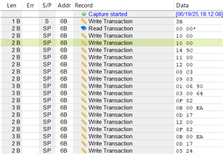

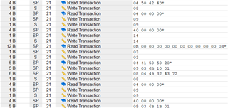

    Thanks for your support earlier.
    I’ve attached the I2C logs captured during:
    • Patch download to the PD controller
    • USB Type-C source connection
    I updated the patch to set charging current to 2A (previously 1A). The patch loads correctly—verified using Customer Use Registers (0x00001234, 0x0000ABCD), which I was able to read back.
    Despite this, charging doesn’t start, and the STAT LED blinks at 1Hz. I manually wrote 0x87 to REG05 (VINDPM), but the board starts pulling current from the battery instead of charging it.
    Register Value Notes
    REG1B 0x0F Power good, VBUS/VAC present
    REG1C 0x10 Not a qualified adapter
    REG1D 0x01 VBAT_PRESENT = 1
    REG1F 0x08 TS_COLD_STAT = 1 (temperature cold)
    REG22 0xAF CHG_EN set
    REG23 0x12 Status flags
    REG25 0x08 TS_COLD_FLAG = 1
    Fault and Mask Registers (0x20–0x2D): All values read as 0x00, indicating no system-level fault latched and no fault/mask condition active. This hints at a temperature or VBUS qualification issue blocking charging.

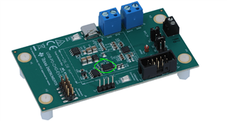

    • On EVM, I used the default binary did not flash my config setup. But with same USB source on the USB-PD-CHG-EVM-01 battery starts charging, but not on my custom board.
    Also, could you please help me with the following regarding EVM programming?
    I currently do not have a flash programmer (e.g., Aardvark/Total Phase) for programming the EEPROM on the EVM.
    → Do you have any reference script or method to flash the EEPROM over I2C, directly from a Linux or Python setup?
    In my working custom setup, I'm bypassing EEPROM and sending the patch binary directly to the PD controller after reset.
    → Is there a way to do something similar with the EVM, bypassing EEPROM?
    I attempted to use the same script I’ve used to read BQ25798 registers via the PD controller, but it fails on the EVM.
    I suspect the EEPROM continuously communicates with the PD controller, possibly overriding or interfering with host-initiated reads.
    Would really appreciate your guidance on, any futher recommended diagnostics
    Aditya
  • HI Aditya,
    Regarding the non qualified adapter, the D+/D- auto detect didn't find a matching adapter so the charger's input current limit (IINDPM) is the lower of 3A or ILIM_HIZ resistor divider clamp.
    Regarding the charger's TS COLD fault, if there is no 10kohm thermistor or resistor from TS to GND and the charger's IGNORE TS remains at default = 0, the charger thinks the battery is too cold to charger.  You can also hardware disable TS by changing the TS pin resistor divider to have matched resistors.
    Jeff
  • Hi Aditya,
    The I2C for sink connection looks correct and matches what I see on a working EVM. From the PD controller side, it looks like everything is working as expected.
    I tried changing: USB Highest Speed? → No,  Legacy Charging (BC1.2)? → No. But no effect on charging.
    Yes, these would have no effect on the charging.
    Do you use the same battery with the EVM?
    If the same source and battery work with the EVM, there may be a schematic issue with your board.
    Could you send the BQ portion of the schematic as well?
    No, we do not have any reference scripts for this. We also do not recommend flashing the EEPROM through the PD controller over I2C if this is what you are asking.
    Potentially.
    Can you try erasing the EEPROM so there is no valid image? The PD controller will attempt to read the EEPROM, but after realizing it does not have a good image, it should wait in PTCH mode.
    Once in PTCH mode, you should be able to access the PD controller through the I2Ct lines on the J3 header, and use the PBMx sequence there. I have not tried this myself, but it should work.
    No, this should not be a problem. The EEPROM is only checked on initial boot, so once the EVM is powered, it should not interfere with host initiated reads.
     I would make sure you are using the correct I2Ct TPS25751 address. If that fails, send me an I2C log of both I2C busses when you attempt to do the host initiated reads, and we might be able to determine what is going wrong.

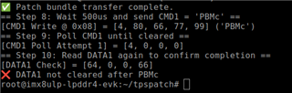

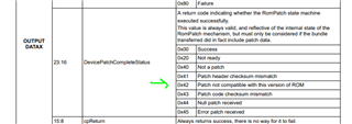

    To cross-verify the behavior, I attempted to charge the battery using the USB-PD-CHG-EVM-01 board. As mentioned earlier, I had written 0xFF to the EEPROM, so the PD controller is now in PTCH mode.
    I reused the same patch download script (used successfully on our custom board) and confirmed that:
    • The patch binary is the Low Region Binary
    • The I2C download sequence completed without byte loss or corruption
    However, with the EVM board, the patch process is failing at Step 10 as per the "Common TPS25751 Use Cases and Settings Using EC" document.
    I’ve attached the I2C logs for your review. Could you please help evaluate what might be going wrong in this case?
    Aditya
  • Hi Aditya,
    If you are reading the value correctly, that return value indicates that the fw you are using is incompatible with the part. What GUI are you using to generate the image, and can you confirm the part being used?
    Can you share the .C file and a full flash you generated, so that I can test the image you generated on hardware on my end?
    Thanks and Regards,
    Chris
    I’m using the USBPCD Application Tool v1.1.0 to generate the firmware image. I’ve selected TPS25751D and BQ25798 in the tool configuration. The EVM being used is USB-PD-CHG-EVM-01, though I'm not fully sure which specific part variant is mounted on it.
    I’ve attached the .c source files:
    • battery_charger.c: Full region binary source
    • battery_charger1.c: Low region binary source
    Unfortunately, I’m unable to upload the .bin files here may be due to platform limitations. Please let me know if there’s an alternate way I can share the generated binary files with you.

    If you have the CHG-EVM, there should be a marking on the U4 IC. It may be difficult to see, but I have found magnifying glasses and taking pictures with a phone camera helpful. If the board has the TPS25750 (which is possible as the old version had the TPS25750, the update to TPS25751 only happened within the last couple months).

    You were also right—we realized the current EVM we have is populated with the TPS25750 instead of the TPS25751. We've placed an order for the correct EVM, but in the meantime, is it possible to replace the TPS25750 with a TPS25751 on the same board for evaluation?
    Yes, it is possible, the two devices are p2p.
