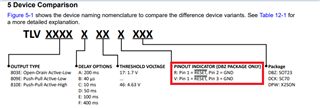

Could you help me with the correct P/N for the Low-power voltage supervisor (reset IC)?  i need
  • TLV803E: open-drain, active-low
  • 2.25V
  • 200 ms
  • SOT23-3 (DBZ) (with pin 3 = GND)
But i just found the P/N TLV803EA22DBZR
How i can be sure that it is SOT23-3 (DBZ) (with pin 3 = GND)?
  • Hi Federico, Thanks for  your question!
    TLV803E is the enhanced alternatives to the TLV803, which offers low quiescent current IQ, higher accuracy, wider temperature range.
    Device nomenclature table also highlights the R and V variant.
