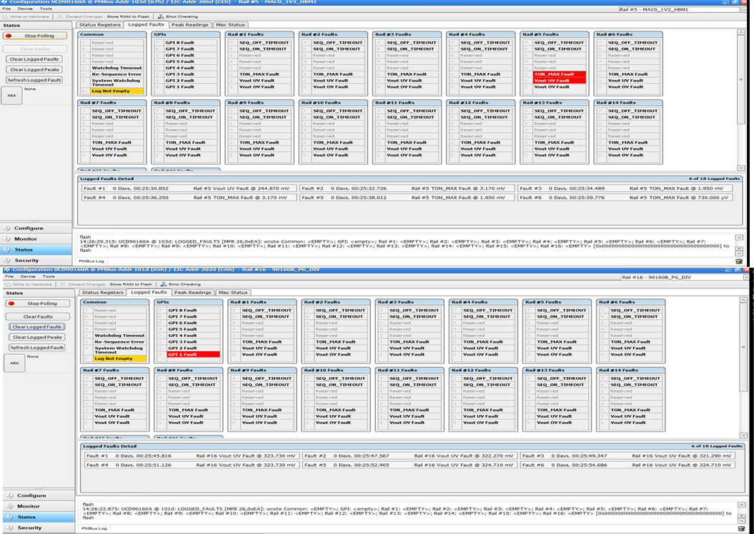

Customer is using configuration below:
https://e2e.ti.com/cfs-file/__key/communityserver-discussions-components-files/196/LSXSUPNCPN02_5F00_V1a.tifsphttps://e2e.ti.com/cfs-file/__key/communityserver-discussions-components-files/196/LSXLPO36DH20EPNCPN03_2600_04_2D00_V14V13.tifsp
Questions:
1. customer found UCD90160A will log multiple Ton_max fault while U21 UCD9090A only log one time.
Is there any configuration will lead to this difference.
