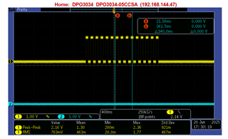

When I tested TPS6594-PMIC chip, and we found when Vbat in the 3.97V, PMIC-25 Pin( nRSTOUT ) will change 0--1.8V, but never change to 0V, please find this picture.

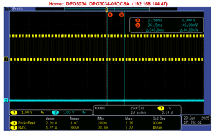

when Vbat in the 4.05V, PMIC-25 Pin( nRSTOUT ) will change 0<-->1.8V period, then will change to 0V, please find this picture.
Could you tell what will cause PMIC nRSTOUT pin still change, never to be 0V,  and what will cause PMIC nRSTOUT pin changes sometimes, then will be 0V later? it depends PMIC output current?
because the Vbat 3.97V, current still change 0.2<-->0.4A,
when the Vbat is 4.05V, the current change 0.2<-->1.5A, then PMIC reset, current is 0.012A

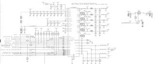

    Two questions:
    1. Do you have a safety FET in your system?
    2. Additionally, can you show us VCCA during the sequence of events for the infinite case and the 15x count case from your original post?
    It would help us to check the sequence of events. The theory relates to the fact that this OPN supports both 5V and 3.3V and checks this as part of the wait4enable section of the PFSM.

    1: I don't know we have or not safety FET, but you can check our SCH.

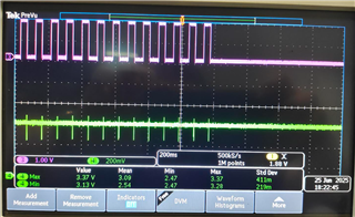

    2: I tested VCCA in the two conditions, pink color is reset, green color is VCCA
    this is PMIC recover 15 times. you can see the VCCA dropped to 3.13V when PMIC restart, and when PMIC reset to 0, VCCA will become to 3.3V.
    this is VCCA when PMIC still restart, never become to 0. Could you tell me why it happened this?
  • Can you also give a zoom of just one of the cycles for each case so I can see more detailed the VCCA behavior? Are you seeing both cases VCCA is at 3.37V - I thought in your issue description you mention 3.9 and 4.05? What is your target voltage for VCCA?

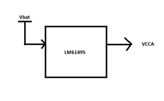

    My VCCA voltage is 3.3V,  and 3.9V / 4.05 is Vbat, Vbat will though DCDC to VCCA.
    LM61495 is 12V to 3.3V, and we will raise Vbat from 0V to 12V, but when the Vbat = 3.9V, the PMIC will still restart, then Vbat = 4.05V, the PMIC will restart 15 times, and reset.
