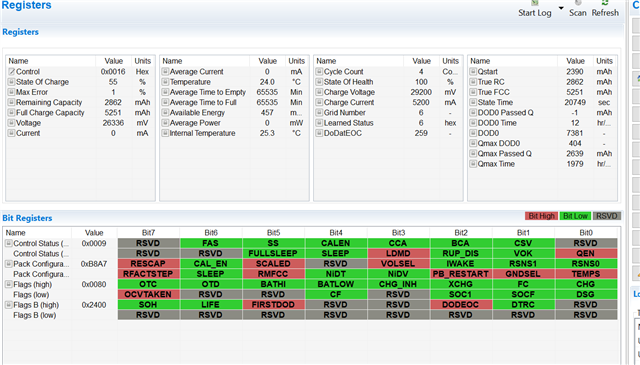

    It has now been 5 days since the discharge cycling has ended, and the SOC has increased all the way to 55%. This is despite the QMax time indicating no QMax update has occurred in 5 days, which is when cycling ended. During these 5 days it seems that an OCV was taken in relaxation as the OCVTAKEN bit became asserted and the VOK bit cleared. The DOD0 value now has jumped greatly since the DOD0 value prior to this OCV reading was last taken near 100% SOC. Although we are using a TI characterized chem ID our SOC has now jumped to 55% when it is expected to be 41%. Can you point me to any reason this huge correction would have been made in relaxation based on OCV? We are using chem ID 0x4201 which was provided to us but it has generated a massive error. I have attached a csv of the data flash as wellgotion_104AH_data_flash.gg.csvGauge Registers after 5 Days of Relaxation
  • The gauge will force an OCV measurement after 172800 seconds in relax (=48 hours). Note that this will not necessarily qualify for a Qmax update but it will update DOD0 and as a result it will update SOC.
    How much did DOD0 change? What is DODatEOC?
  • Thanks for the fast reply Dominik. DOD0 5 days ago after the three discharges was 404, the DOD0 value now is 7381. The 404 for DOD0 was constant both before and after the three discharge cycles, which makes sense to me as we only allowed the battery to relax for an hour before beginning the subsequent discharge cycle and after the charge to full (no relax = no DOD0 OCV measurement taken, no QMax update etc). DoDAtEOC is now 259, and 5 days ago after the three discharge cycles it was 244. Before the three discharges (it was @99% before the 3 discharges) the DoDAtEOC was 208.

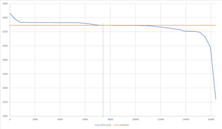

  • The problem with this is that the cell's relaxed voltage falls into a voltage zone where the ChemID can't resolve DOD accurately.
    Here is the OCV for ChemID 4201 for a single cell together with the single cell voltage from our screenshot:
    That's why the gauge adjusts this to DOD0 = 7381.

  • 1.The register states after the jump to 55% don’t indicate any reset. My QMaxTime for example kept incrementing forwards in time relative to the last QMax update nearly a week before. Unless I am mistaken wouldn’t that be a register that would reset have reset to zero since no QMax update would have occurred after reset without a substantial charge or discharge?
    2. I have zero’d this gauge and the deadband is high enough (400mA) that I have never seen any noise that causes the gauge to read a non-zero current measurement in idle. I have zero’d this gauge. But, I am confused a bit. I see in the log in when the first correction occurs which moves the SOC from 41 to 42% the QMaxPassedQ continuously decreases although the current is zero; it seems this decrease continues, beginning from 3055 at the end of discharge to 2639 by the time the jump to 55% occurs. Again, this seems decoupled from any non-zero current measurement: How could this be? I was under the impression any current below the deadband wouldn’t be integrated
  • #1: Please make sure that the gauge was in the correct state (relax) all the time. The Quit Current Threshold should be set to C/25 and the Dsg and Chg Current Thresholds should be set to C/15.
    #2: If QmaxPassedQ changes then the gauge at least "measured" an error (non-existing current). The current deadband doesn't mean that the gauge rejects any current below this number. All it does is report 0mA for a current that is below this setting. If you set this to 400mA then the gauge will still accumulate passed charge if it measures <400mA (e.g. if it measures 399mA then it will accumulate 399mAh in one hour) while reporting a zero current.
