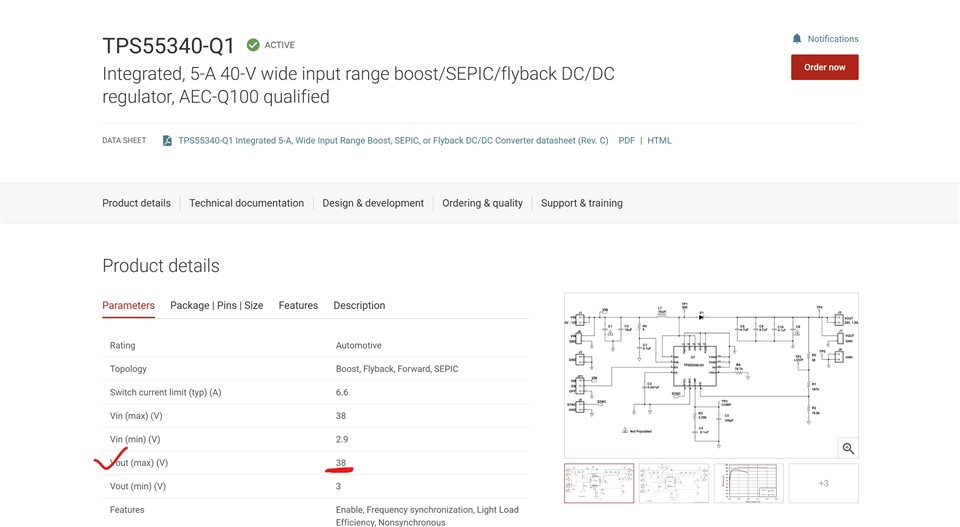

  • Hi Stefan,
    I was just checking the IC specification on TI website and there it was mentioned that the suggested IC (TPS55340) can support output voltage upto 38V. I am attaching screenshot of the website for your reference. Can you please clarify this or suggest some other integrated FET boost IC that can go upto 40 V?
    Vivek
  • Hi Vivek,
    the TPS55340 has an abs max rating of 38V but based on your spec you need 40V. So this will not fit.
    I also do not think that a power stage can handle 5V input to 40V output with 3A output power. This will give an input current of 24A.
    So I recommend to go for external MOSFET solution.
