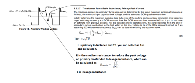

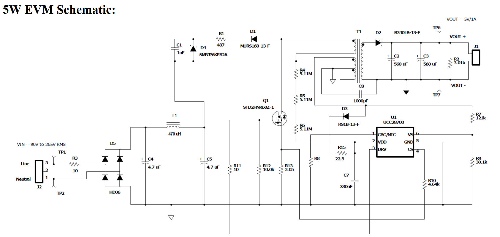

I have compared the circuit presented in SLUA653C (page 18, see below) with the circuit in SLUM619. I noticed that components C15 and R20, which are defined in the TINA-TI circuit of SLUM619, are not present in the circuit of SLUA653C. I would appreciate it if you could explain the purpose of these components in the simulation and how their values are determined.
Circuit of SLUA653C:
Circuit of SLUM619:
