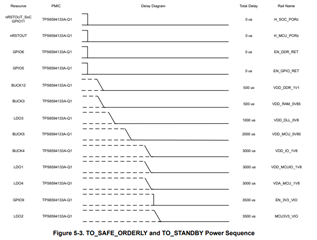

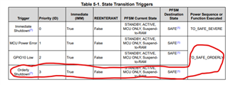

As per datasheet Moderate Error warning causes the device to trigger the PFSM to execute orderly shutdown. How should SOC/MCU shall react in these cases.
Is this MODERATE_ERR_INT will trigger nRSTOUT ?
Is it suggested to reset the MCU by reading the errors and do we need to perform any action at PMIC level like to power off the PMIC supply and power on again to recover from the fault.
