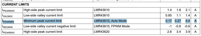

We don't have data for this, but the nature is the following: as load current increases the SW frequency also increases. Also, an you please let me know why do you exactly need this plot, so that I can help with some other option.
Pramanik Patel
PFA the attached excel that will give you frequency for corresponding load current. I have taken values for the EVM.
Vin = 12V
Vout = 3.3V
Ipeak(min) = 0.27
L = 3.3uH
FSW in CCM = 2.2 MHz
