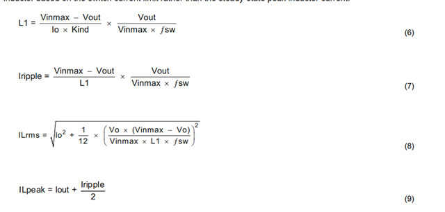

  • You will need to know the inductor and part number and swithcing frequency.
    Use equation 7 below to calculate ripple.
    Fsw is switching frequency
    Lo is inductance, check inductor datasheet and lower inductance using Lo vs current curve in datasheet.
    Ipeak eq 9 should be less than 11.7A based on the ec table, to avoid current limit
    Ivalley should be less than 9.4A based on the ec table, to avoid skipping hs fet turn on and current limit
    ILvalley =  Iout – Iripple/2

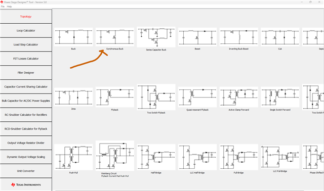

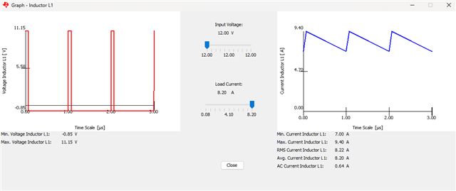

    Alternately, use can download and use POWERSTAGE-DESIGNER Design tool | TI.com
    Enter input, output votlage, switching frequency, inductor and output current values
    and click the inductor to show the peak and valley values
    Read min and max inductor current.

  • Itoh-san,
    Is the 8.2A output current, continuous for 100% of the operation or closer to 10%.
    What are the power on hours.       8.2A is not much greater than 8A.
    There are customers considering TPS543820 for >9A  (~10% of time) applications.
    For that use case, electromigration was reviewed and considered good.
    I do not have a concern about the 8.2A.    What do we need to do to convince customer.
    Customer can use evm and change inductor so it can source an output current closer to the current limit to check performance.
