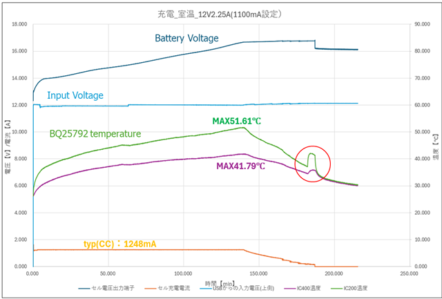

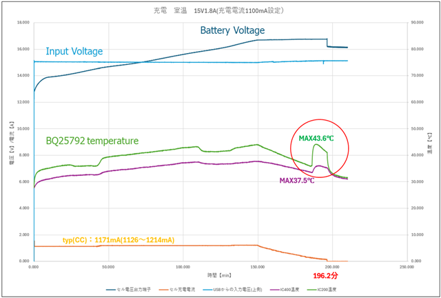

While evaluating the charging characteristics of the BQ25792, we found that the device heats up when switching from constant current (CC) to constant voltage (CV).
 - Input voltage : 15V, Charge current : 1.1A, Battery 4S,16.4V
The BQ25792 performing the charging process is IC200 (green), and the temperature reaches 43.6°C before switching to CV.
 - Input voltage : 12V, Charge current : 1.1A, 4S,16.4V
The BQ25792 performing the charging process is IC200 (green), and the temperature reaches about 43°C before switching to CV.
I thought that the PWM operation at light load was affecting this issue, It noticed no change in this heat generation with either the PWM or PFM settings.
Do you know what causes this phenomenon?
Masashi

  • Hi Masashi,
    I just spoke to the designer and he reminded me that at light load, the charger's converter turns on a 30mA pull down current at SYS.  This additional load current keeps the converter stable.  This is the likely cause of the die temp spike.  I have lab time later today and will test to confirm.

  • Hi Masashi,
    I tested my EVM on the bench and only see an large increase in die temp if I turn off PFM.
    Jeff
  • Hello Jeff,
    We can see that the power at 30mA pull-down and 16.4V(battery 4s) is 492mW.
    The package thermal resistance of the BQ25792 is approximately 44.2°C/W, so a temperature rise of 21.8°C is expected.
    The measured waveform shows a temperature rise of nearly 10°C, and we understand that this is due to the 30mA pull-down.
    Masashi
