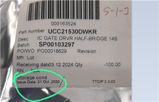

  • Hi Hirkoki;
    We had tried ABA swap test and fail IC still not working on the good hardware. We measure pin to pin impedance.
    Working IC  Fail IC
    VSSA-VDDA 362K 350K
    VA-VDDA 370K 356K
    VSSA-VA 388K 388K
    INA-GND 183K 190K
    INB-GND 190K 190K
    IC ıssued date 21 oct 2020.
