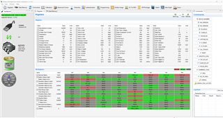

Hi all,
I have conducted the data collection for my battery pack and the purpose is for recommended checmID using this pack with BQ27Z561 GG.
The reason I selected this GG because it will be able to support my battery pack capacity of 10Ah, 3.7V
However, in the report I got back, I only see the best chemical ID is 3241, and below are the list of recommended GGs.
I don't see anything relate to my BQ27Z561 GG.
May I ask if I miss anything to indicate that I am looking for chemID for specific BQ27Z561 GG?
10Ah_Capture-report.zip
