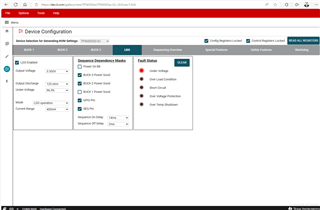

We try to rewrite TPS650320-Q1 LDO Voltage Output for using BOOSTXL-TPS65033 at TI GUI Galley.
We can write our setting Voltage first time, but we can not rewrite after that.
Is it impossible rewrite several time?

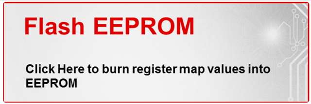

     Also, did you use the "Flash EEPROM" button for the voltage you changed?

  • Hi, Phil.
    Thanks to reply.
    It's TPS65032001RGERQ1.
    Yes, I used that button to change voltage.
    But, we can't change voltage more than twice.
    Thanks!
    Jeongho.

  • Hi Jeongho,
     it's not okay to set EEPROM_PROG_CMD (0x4A) = 0x00. Please write "2Dh" only to EEPROM_PROG_CMD (0x4A) to program EEPROM.
    Thanks!
