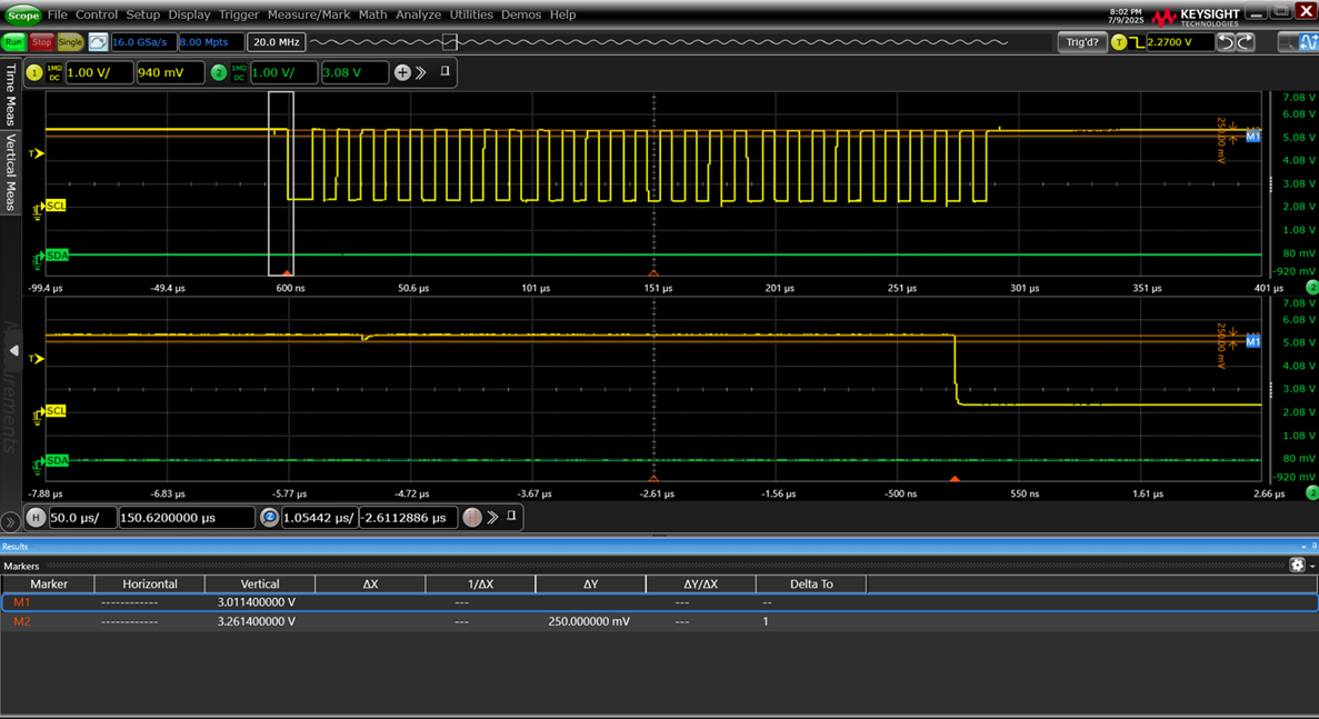

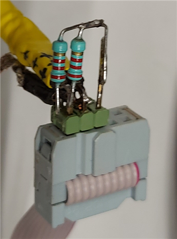

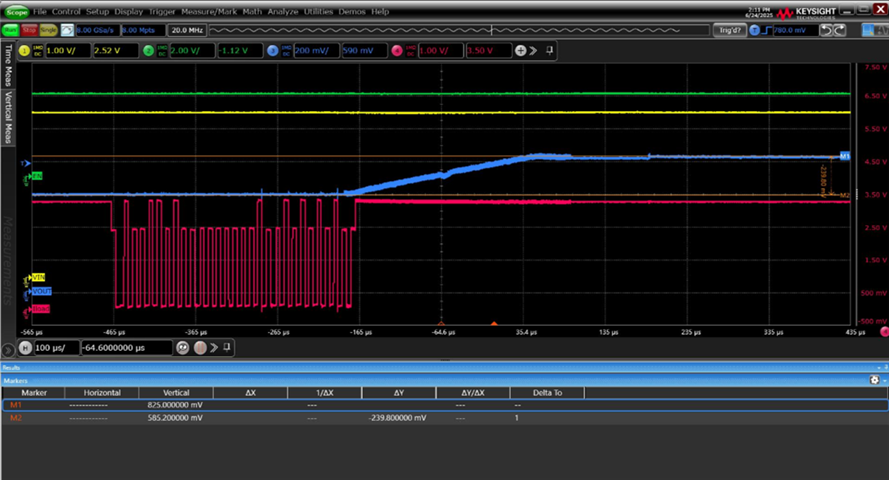

  • During the I2C command pull-up process, we observed that the I2C voltage has two levels: 3.3V and 2.5V. Is this due to an internal mechanism? (The external I2C pull-up is 3.3V.)
    (We use our own MCU to config)

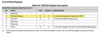

  • Regarding the OTP function of the PS628681A, I used an external heat source along with a loader to draw 4A, but still could not trigger the OTP at 150°C. Even the surrounding solder has melted. Has this feature been modified?
