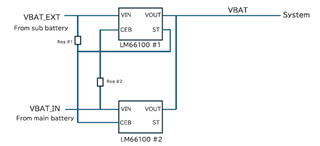

I am creating an ORing circuit using two LM66100s.
I have two questions:
(Question 1)
In the circuit below, if 3V is applied to VBAT_IN and VBAT_EXT is left open, can the ST pin of M66100 #1 be driven low?
(Question 2)
Both VBAT_IN and VBAT_EXT are used at 3V.
When VBAT_IN drops and switches to VBAT_EXT, a drop is expected in the output VBAT.
The system cannot tolerate a large drop, so I would like to keep the drop to around 30mV.
In that case, how should I devise the circuit?
