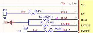

Hi, I did some tests with the TPS1HTC30. I observed a situation I don't understand and I couldn't find explanation in the datasheet.
The situation is; when the current is close to the limit (about 10% below the current limit), the fault drops and the IC starts to heat up.
Our think is reduces the Gate voltage with the Fault Flag.
So what causes this situation?

  • Hi Rishika,
    Our ILIM resistor is 24.9K Ohm and current limit is 4A.
    Fault goes low around 3.6A.
  • Hi Oguzhan,
    Since parameters may vary across PVT (process, voltage, and temperature), we would have to consider the tolerances given. So, the ILIM range is 3.2/4.0/4.8A (ILIM = KCL/RILIM) as the MIN/TYP/MAX respectively based on the KCL range given and RILIM = 24.9k.
