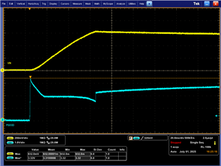

Hello. In my application I use VIN=2.5V, and PGOOD pulled up to 3.3V rail, trough 10kOhm resistor. My 3.3V rail is enabled much earlier than the 2.5V.
I noticed that my disabled 2.5V rail is back-powered, and charged up to ~620mV from PGOOD pin. Voltage on PGOOD also indicates current being drawn.
I attach a scope screenshot.
Can you please confirm that there is some kind of ESD or clamping circuit between PGOOD and VIN pins? This is not mentioned in datasheet. Absolute maximum rating for PGOOD is 6.5V and recommended max. is 3.5V.

  • Hi James. I made a 10k vs. 100k pullup resistor comparison as you suggested. See the screenshot. The charging is slower, but voltage of charged VIN is not much lower (0.6V vs. 0.45V).
    My supervisor microcontroller is working on 3V3. In next design loop I will probably reconnect this PGOOD to VIN=2V5 and use a transistor level shifter.
    But just to make sure, I'd be grateful for your confirmation that there is a path between PGOOD and VIN inside the package.
    Rafal

  • Hi Rafal,
    This is what I'm seeing on the EVM when I ramp up 3.3V on PGOOD through a 10k resistor.
    This seems to be a direct match to what you see on your end. My VIN charges up a bit higher (632mV)
    Capture 1: Zoom-in on the 3.3V rising action with VIN

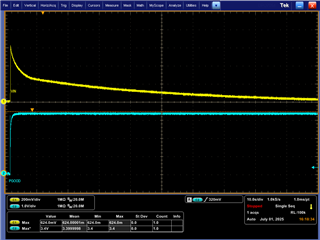

    Capture 2: Zoom-out to show the decay of VIN. It takes 100+ seconds for VIN to fully discharge when the pin is floating (input capacitors present)
    James
