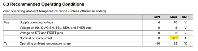

What is the maximum current on each channel?
Is there a reference design?

Hi Jegan,
The max current on each channel is 2.5A.
You can use the EVM User's Guide for a reference design. It contains a schematic and layout.
https://www.ti.com/lit/ug/slvuao8/slvuao8.pdf
