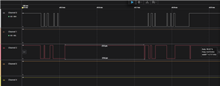

Hello TI team,
I was trying to write configurations as per the technical reference manual of BQ76972 but unfortunately I am receiving error as I have also checked the waveforms. As BMS IC is not acknowledging I2C writes to 0x3E, which is how I can begin memory writes. In addition, I have entered exact same addresses and commands according to the reference manual. I write subclass "0x80" and offset "0x5C" which comes from "0x92FF-0x92A3 = 0x5C". Here 0x92A3 because it is the starting base address of subclass "0x80". So, please help me out here for any correction.
I have attached the code and require

d output data's for the reference.
  • Hi Harsh,
    Please refer to the Technical Reference Manual (https://www.ti.com/lit/ug/sluuby2b/sluuby2b.pdf) for instructions about the register and how to communicate with the device. We can answer specific question about the device, however we expect our customer to be able to review/debug their code. If you have an issue with the microcontroller, please reach out to the MCU team. If you have a specific question about the TRM, please post another thread with the same. Thank you.
    Please refer to the programming guide for help and examples you can use to debug (https://www.ti.com/lit/an/sluaa11b/sluaa11b.pdf), also make sure your I2C IRQ on your MCU supports clock stretching for proper operation.
