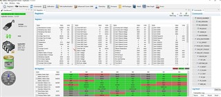

My customer have a battery pack of 21700 cell (4S1P), during the use of the SOH value has become very low, recharge and discharge will resume normal.
Use the scenario description:
1, the battery transportation process uses shutdown mode. Plug-in active at user.
2, normal use at the user, about 1 to 2 months found SOH abnormalities (70%, 80%), These batteries are new and the customer has confirmed that the cells are good. The user's operating state is battery-only at night, and battery-powered and acdc-powered during the day.
Can you help analyze why SOH falls? How we should avoid it.
We got the abnormal chip and read the registers as shown in the figure:
