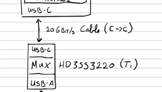

  • Hello Ryan,
    To clarify my setup please see my hand sketch below.
    The PCIE card has both A and C ports.
    I have no further information on Capacitance on the lines of this expantionboard.
    I attached 2 sheets of my design that is currently not functioning.

  • Hi Erwin,
    Got it, thanks.
    Just to confirm, this cable is 20Gbps, but the connection itself is being done over USB3 at 5Gbps or 10Gbps, correct?
    Is there any way you can monitor the DIR and CC lines on the HD3SS3220 EVM? I know it may be hard, considering the boards size. I would like to check those and make sure an active CC connection is being made, If there is a connection I believe there should be a voltage on one of the CC lines, and the DIR pin should be flipping accordingly.

  • Hey Ryan,
    I ordered an 20Gbps cable just to be shure this wouldn't be the bottle neck. the max speed needed is 10Gbps.
    I measured the DIR pin with an oscilloscope and it clearly switches from high to low when i flip the USB-C cable. this seems to work.
  • Hi Erwin,
    Then it sounds like the HD3SS3220 mux is switching properly most likely.
    Is it possible to monitor the CC pins and ensure there is a connection thereThere should be a voltage on one of the lines indicating a connection, what is the voltage you're seeing there?
    Is it possible to monitor the TX or RX lines and look for any activity on those lines? If there is a connection, you should be able to see activity on the RX and TX lines. If not, and you only see small pulses on the TX lines of the USB-A connector on the HD3SS3220 board, then that would indicate no connection is being made, If you don't see any signal on those pins at all, then the mux might not be flipping correctly.
