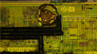

Based PO#TO5669441    TPS562242DRLR ,we have below questions ,can you assist to reply ?

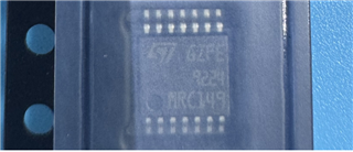

1.Regarding label
Additional COO on the bottom left, Country Philippines is misspelled as "Philippine" . Can TI explain ?
Why NO  location and country information for Wafer fab and Assembly site  ?
Can you confirm this label below is from TI based on PO# TO5669441   ?

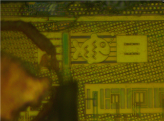

2. Regarding die
We do 1 pc decap was performed but there is no MFR nor MPN observed in the die.
 May I know why ? Pls explain .  See the attached decap photos .
