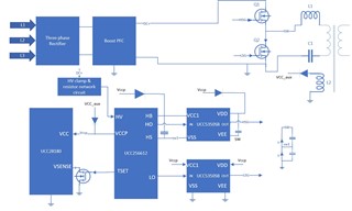

    Let me explain my concern related to LF burst mode. we are using UCC256612 for 800V-24V/17A DCDC. Since HS pin of IC is rated for ~600V, we are using additional UCC5350SB gate driver and capacitive divider to interface switch node to IC HS pin.  You must be aware as this was suggested in this forum by you. If we consider Q-current of primary (2.4mA) and secondary side (1.8mA) of gate driver and LF burst off time, required bootstrap capacitance value (17V gate drive voltage and UVLO is 8V) is coming in the range of >=30uF, which is very high. Need your guidance in this case.

    Can you share your schematic? I agree, 30uF for a bootstrap capacitor is way too high. This should not be required with the gate driver.
    As for reducing the time between LF packets, this can be done by adjusting the burst entry point with the LL pin. Actually, the datasheet does not have a practical minimum recommendation for this value. I will have to get back to you on this.
    Thanks for the response. I can not share the complete schematic. But please find attached below image for the concept.

  • HI Dhananjay,
    For the UCC256612, you don't need a large bootstrap capacitor. 1uF should be more than enough as we are only driving a logic level input.

    Agree if only UCC256612 is used, HB-HS pin q current is ~100uA and 1uF is more than enough. As we are using additional gate driver UCC5350SB, basically there two bootstrap loops. One is on primary side of gate driver and other at secondary side of gate driver. Primary side Q current (UCC256612 HB-HS pin + UCC5350 primary) is (~2.5mA) and secondary side Q current (UCC5350 secondary side is ~1.8mA. With LF burst off time of 150msec, required both bootstrap capacitor value is >30uF.
