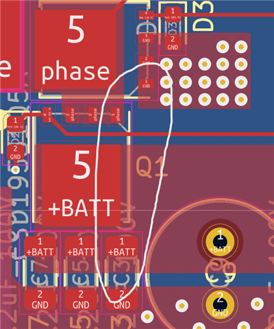

  • Hi Tim,
    I was looking at the eval board design for the LM5145, optimization of the power stage design(link). As far as ive understood it shows different layouts and the hot loop taken by the switching current in different layout and placement styles. Figure 1 is the least optimal approach that needs to be used as the switching current loop is big and hence higher EMC. Figure 2 - Improved lateral switching loop design is better than figure 1 as the loop now is much smaller than the previous. Then the best approach for minimuising the hot loop would be layout style given in figure 3, the vertically oriented switching loop.
    In one of my test design I have something similar to figure 2, except for the capacitors being 180 degrees from what is shown in figure 2. So am i right is assumin that this is a bad layout as the switching loop for the current is big.

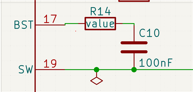

  • Hi Karthik,
    Yes, smaller loop area is always better, but yours looks reasonable. I would go with zero gate resistance (and include a resistor in series with the boot cap as an option).
    If the duty cycle is < 50%, then the high-side FET conducts less than the low-side FET. Thus, the high-side FET can be higher Rdson, lower capacitance, which helps switching losses.

  • Hi Tim,

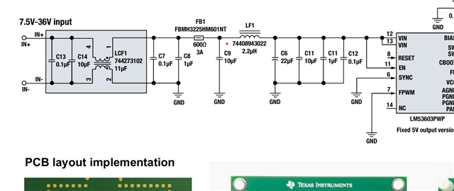

    1. The boot capacitor that you have mentioned is the one on the BST pin i assume. Include a resistor with the boot cap in series going to the pin of the ic ? Somthing like this ?
    This was given in the TI high density evaluation module -

  • Hi Karthik,
    !. Yes, a resistor in series with the boot cap.
    2. 250kHz is a good tradeoff of efficiency vs. size. Choose the inductor based on the quickstart calculator recommendation, ~30% ripple current.
    3. Rdson lossless sensing is recommended. See the data sheet for more detail. Use a soft-sat inductor, e.g. powdered iron material.
    4. Yes.
    5. A normal Pi filter (with damping) is often adequate. However, if meeting CISPR 25 Class 5 is the target (up to 108MHz), then a CM choke is often useful.
