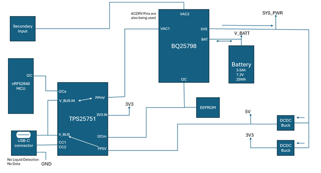

BQ25798: Issue with BQ25798 Not Switching to Secondary Input When USB-C Port is Damaged – REG12 = 0x20, OTG_OVP Triggered
Part Number: BQ25798
Other Parts Discussed in Thread: TPS25751,
Hello TI Support,
We are currently using the TPS25751 and BQ25798 in our design with the configuration as described below. We are encountering an issue where the system fails to charge the battery from the secondary input when the USB-C port (primary input) is damaged. Your assistance in diagnosing and resolving this issue would be greatly appreciated.
System Configuration Overview (Block Diagram Attached):
  • Primary Input: USB-C port connected to VAC1 of the BQ25798 via the TPS25751.
  • Secondary Input: Connected to VAC2 of the BQ25798.
  • TPS25751 Setup:
    • Operating in DRP mode.
    • No USB data (D+/D- connected).
    • SBU1/SBU2 are not usedLiquid Detection is disabled.
    • EEPROM image configured (

  • ACDRV1 / ACDRV2: Properly implemented with FETs for VAC1 and VAC2 path control.
  • Battery Charging: Allowed via both USB-C (VAC1) and secondary input (VAC2).
  • Battery Discharging/OTG: Enabled over USB port through PP5V rail derived from a buck converter.
  • Here is the block diagram explaining the connections
When the USB-C port is damaged, we expect the charger to fall back and allow charging from the secondary input (VAC2). However, in this failure mode:
  • The battery does not charge via the secondary input.
  • The BQ25798 register Charger_Control_3 (0x12) changes from the default 0x00 to 0x20.
  • The OTG_OVP/OTG_UVP flag is being set in FAULT_FLAG_1 (0x27).
This behavior seems to be inhibiting VAC2 charging when the primary VAC1 input (USB-C port) is compromised.
  1. Can you explain what might cause the REG12 value to change to 0x20 in this scenario?
  2. Under what conditions does OTG_OVP/OTG_UVP gets triggered, especially when OTG was not actively engaged from our side?
  3. Is there any possibility that the TPS25751 is sourcing 5V back into the system unintentionally?
  4. How can we ensure a robust fallback to the secondary input (VAC2) when VAC1 path is faulty or unpowered?
Any insights or troubleshooting suggestions with this configuration would be greatly appreciated.
Thank you,
  • Hi Sai,
    Regarding 1, I do not know why REG0x12 would change to 0x20.  There is no feature/fault that auto sets that bit. It user controlled.
    Regarding 2, OTG_OVP/OTG_UVP is not valid unless OTG is active.  Is it possible that backup mode (auto fast turn on of OTG) in REG0x0F[0] was enabled?
    Regarding 3, that is a controller question.  I will move this post to that team but I will still be on the thread.
    Regarding 4, as long as VAC2 passes poor source detection when attached, it is considered a valid input source.  Once VAC1 falls below VBUS UVLO, VAC2 input turns on.  I just repeated with an EVM on my test bench to be sure.
    Can you send REG0x1B through REG0x27 immediately after USB-C crash?  Is USB-C crash pulling VAC1/VBUS below ground?  How do you get the charger to start functioning again, i.e. do you have to remove both input sources and the battery or does removing/replacing the VAC2 fix the issue?  If you toggle REG0x12[7] (disable ACDRVx), does that turn on VAC2?
    Jeff

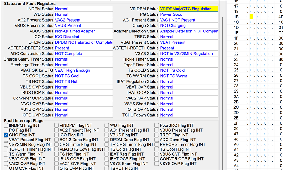

  • Hi Jeff,
    Thank you for your detailed response.
    Regarding point 1:
    Thanks for the clarification. Just to confirm, we are not writing any value to REG0x12 during operation. It's helpful to know that this register is purely user-controlled and not set by any internal mechanism or fault condition.
    Regarding point 2:
    We have verified that REG0x0F[0] (Backup Mode) is not enabled—it remains at 0 even when the USB port is compromised. So, it seems unlikely that the OTG path is being activated through this feature.
    Regarding point 3:
    Appreciate you forwarding this to the Controller team and staying on the thread.
    Regarding point 4:
    Thanks for the clarification and for testing it on the EVM.
    To provide more context on our observations:
    Once we remove the USB port connection from VAC1, the charger resumes normal operation. In addition, we also perform a warm reset on the TPS to restore full functionality. We had tried toggling the ACDRVx bits during the USB-compromised state, but unfortunately that didn’t trigger the BQ25798 to switch over to the secondary input (VAC2).
    Here are the register states observed during various stages:
    • Before USB port fails:
      • TPS25751 Type-C State (0x69): 0x00264 / 0x02064 / 0x02264
      • BQ25798:
        • Status0 (0x1B): 0x00
        • Control3 (0x12): 0x00
        • Control0 (0x0F): 0x82
        • Fault-Flag1 (0x27): 0x00
        • Charger-Status1 (0x1C)[5-7]: 0
    • Just before USB fails:
      • Control0 (0x0F) briefly changes to 0x86 and then reverts to 0x82
      • TPS25751 Type-C State (0x69) changes to 0x03365
    • During USB port failure:
      • Charger-Status1 (0x1C)[5-7]: non-zero (observed values: 1 or 3)
      • Status0 (0x1B): 0x20
      • Control3 (0x12): 0x20
      • Control0 (0x0F): 0x00
      • Fault-Flag1 (0x27): shows OTG_OVP fault
      • TPS becomes unresponsive, with I2C communication errors during 4CC transactions. A warm reset is performed as a recovery mechanism.
    After performing the warm reset, both the TPS and BQ25798 return to normal operation, and charging resumes correctly.
    Let me know if there’s any additional information that would help debug this further. We’re continuing to investigate on our end and appreciate your support.

  • Hi Sai,
    The TPS25751 does not set the EN_ACDRV bits on the BQ25798 in the current implementation. The integrated I2C control is from the perspective of one PD input. See the following thread for more information on how the TPS25751 controls the BQ25798 during different modes of operation. When the Type-C cable is detached, the TPS25751 sets the BQ to a safe state, disabling charging and OTG mode. This would inhibit the battery from charging even when the second input is valid since the BQ is being controlled by the PD.
    A couple questions:
    1- Do you have an MCU in the system that could control the BQ?
    2- Is the PD sourcing 5V/2A  from PP5V? Would you need to source >5V in your application?
    Aya Khedr

    Can you confirm that the ADC's VBUS channel is reporting a valid input voltage?  If so, can you provide the charger's REG0x1B through REGox27 status and fault registers?
    Jeff
  • Hi Jeff,
    Yes, the ADC's VBUS channel is reporting valid input voltage readings.
    With the USB port compromised, here are the VBUS ADC values and the charger status/fault register values (REG0x1B through REG0x27) under different VAC conditions:
    1. VAC1 Inactive & VAC2 Inactive
    VBUS ADC: 0
    BQ Registers:
    • 0x1B: 0x00
    • 0x1C: 0x00
    • 0x1D: 0x01
    • 0x1E: 0xC0
    • 0x1F–0x27: 0x00
    2. VAC1 Inactive & VAC2 Active
    VBUS ADC: 17409
    BQ Registers:
    • 0x1B: 0x4D
    • 0x1C: 0x10
    • 0x1D: 0x01
    • 0x1E: 0xC0
    • 0x23: 0x80
    • All others: 0x00
    3. VAC1 Inactive & shortly after VAC2 becomes Inactive
    VBUS ADC: 3420
    BQ Registers:
    • 0x1B: 0x05
    • 0x1C: 0x10
    • 0x1D: 0x01
    • 0x1E: 0xC0
    • 0x22: 0x10
    • All others: 0x00
    4. VAC1 Inactive & after VAC2 becomes Inactive
    VBUS ADC: 490
    BQ Registers:
    • 0x1B: 0x00
    • 0x1C: 0x00
    • 0x1D: 0x01
    • 0x1E: 0xC0
    • All others: 0x00
    Let me know if you need a deeper breakdown of any specific condition or register.
    Sai
  • HI Sai,
    In 2 above, the charger is in VINDPM and not charging.
    VINDPM means that the VINDPM threshold is higher than the applied voltage at VBUS.  NOT charging means either CE pin or bit is not configured for charging. When USB-C port is no longer providing power, the TPS25751 firmware disable CE bit in REG0x0F.  The firmware will need to change or a processor with I2C host will need to change that bit and lower VINDPM threshold.
    Jeff

      write to 0x21 ack data: 0x28
      read to 0x21 ack data: 0x11 0x02 0x00
      write to 0x21 ack data: 0x09 0x04 0x6B 0x10 0x01
      write to 0x21 ack data: 0x08 0x05 0x49 0x32 0x43 0x72
      read to 0x21 ack data: 0x04 0x49 0x32 0x43 0x72
      read to 0x21 ack data: 0x04 0x00 0x00 0x00 0x00
      read to 0x21 ack data: 0x40 0x00 0x80
      write to 0x6B ack data: 0x0F 0xA2
      write to 0x6B ack data: 0x10
      read to 0x6B ack data: 0x80
      write to 0x21 ack data: 0x09 0x06 0x6B 0x02 0x10 0x88 0x00
      write to 0x21 ack data: 0x08 0x05 0x49 0x32 0x43 0x77
      read to 0x21 ack data: 0x04 0x49 0x32 0x43 0x77
      write to 0x6B ack data: 0x10 0x88 write to 0x21 ack data: 0x40
      read to 0x21 ack data: 0x04 0x30 0x00 0x00 0x00
      write to 0x21 ack data: 0x1A
      read to 0x21 ack data: 0x05 0x00 0x00 0x30 0x00 0x00
      write to 0x21 ack data: 0x09 0x04 0x6B 0x1C 0x01
      read to 0x21 ack data: 0x40 0x00 0x70
      write to 0x21 ack data: 0x09 0x04 0x6B 0x3B 0x02
      read to 0x21 ack data: 0x40 0x00 0x20 0x75
      write to 0x21 ack data: 0x09 0x04 0x6B 0x33 0x02
      write to 0x6B ack data: 0x1C
      read to 0x6B ack data: 0x70
      write to 0x6B ack data: 0x3B
      read to 0x6B ack data: 0x20 0x75
      write to 0x6B ack data: 0x33
      read to 0x6B ack data: 0x04 0x1E
      write to 0x6B ack data: 0x03
      read to 0x6B ack data: 0x00 0x64
      write to 0x6B ack data: 0x06
      read to 0x6B ack data: 0x01 0x2C
      read to 0x21 ack data: 0x40 0x00 0x04 0x1E
      write to 0x21 ack data: 0x09 0x04 0x6B 0x03 0x02
      read to 0x21 ack data: 0x40 0x00 0x00 0x64
      write to 0x21 ack data: 0x09 0x04 0x6B 0x06 0x02
      write to 0x6B ack data: 0x05
      read to 0x6B ack data: 0xB3
      write to 0x6B ack data: 0x1B
      read to 0x6B ack data: 0x0D
      read to 0x21 ack data: 0x40 0x00 0x01 0x2C
      write to 0x21 ack data: 0x09 0x04 0x6B 0x05 0x01
      read to 0x21 ack data: 0x40 0x00 0xB3
      write to 0x21 ack data: 0x09 0x04 0x6B 0x1B 0x01
      read to 0x21 ack data: 0x40 0x00 0x0D
      write to 0x36 ack data: 0x00
      read to 0x36 ack data: 0x80 0x80
      write to 0x21 ack data: 0x09 0x04 0x6B 0x20 0x01
      write to 0x21 ack data: 0x08 write to 0x6B ack data: 0x1B
      write to 0x6B ack data: 0x20
      write to 0x21 ack data: 0x09 0x04 0x6B 0x21 0x01
      write to 0x21 ack data: 0x09 0x04 0x6B 0x26 0x01
      write to 0x21 ack data: 0x09 0x04 0x6B 0x27 0x01
      write to 0x6B ack data: 0x21
      write to 0x6B ack data: 0x26
      write to 0x6B ack data: 0x27
      write to 0x6B ack data: 0x22
      read to 0x6B ack data: 0x89
      write to 0x21 ack data: 0x09 0x04 0x6B 0x22 0x01
      write to 0x6B ack data: 0x35
      read to 0x6B ack data: 0x4B 0x2F
      write to 0x6B ack data: 0x12
      read to 0x6B ack data: 0xA2
      read to 0x21 ack data: 0x40 0x00 0x89
      write to 0x21 ack data: 0x69
      read to 0x21 ack data: 0x04 0x00 0x00 0x00 0x66
      write to 0x21 ack data: 0x09 0x04 0x6B 0x35 0x02
      read to 0x21 ack data: 0x40 0x00 0x4B 0x2F
      write to 0x21 ack data: 0x09 0x04 0x6B 0x12 0x01
      write to 0x21 ack data: 0x09 0x04 0x6B 0x0F 0x01
      read to 0x21 ack data: 0x40 0x00 0xA2
      write to 0x21 ack data: 0x09 0x06 0x6B 0x02 0x05 0xBE 0x00
      write to 0x21 ack data: 0x09 0x07 0x6B 0x03 0x06 0x00 0x46 0x00
      write to 0x21 ack data: 0x09 0x04 0x6B 0x39 0x02
      write to 0x6B ack data: 0x05 0xBE
      write to 0x6B ack data: 0x06 0x00 0x46
      write to 0x6B ack data: 0x39
      read to 0x6B ack data: 0x4B 0x40
      write to 0x6B ack data: 0x05 0xBE write to 0x21 ack data: 0x08
      read to 0x21 ack data: 0x40 0x00 0x4B 0x40
      write to 0x21 ack data: 0x09 0x06 0x6B 0x02 0x0F 0xA2 0x00
      write to 0x6B ack data: 0x0F 0xA2 write to 0x21 ack data: 0x09
      write to 0x21 ack data: 0x09 0x07 0x6B 0x03 0x03 0x00 0x96 0x00
      write to 0x6B ack data: 0x03 0x00 0x96 write to 0x21 ack data: 0x40
      read to 0x21 ack data: 0x05 0x20 0x00 0x30 0x00 0x00
      read to 0x6B ack data: 0x20 0x71
      read to 0x6B ack data: 0x03 0xE4
      read to 0x6B ack data: 0x00 0x96
      0x32 0x43 0x72
      read to 0x21 ack data: 0x40 0x00 0x20 0x71
      read to 0x21 ack data: 0x40 0x00 0x03 0xE4
      read to 0x21 ack data: 0x40 0x00 0x00 0x96

  • Hi Jeff,
    We are sending the 4CC I²C command  to the TPS25751 continuously (every 1 second) to enable charging on the BQ25798 i.e. 0x0F[5] = 1, regardless of the status of VAC1 or VAC2.
    As soon as we connect a breaker circuit (a simple USB-C breakout with CC1 & CC2 pulled to VBUS) to the USB port connected to VAC1 (via TPS PPHV as shown in the above block diagram), the Control0 register changes from 0xA2 to 0x82, indicating that charging has been disabled.
    Interestingly:
    • If we apply voltage to the breaker circuit, or
    • If we completely remove the breaker circuit from the USB port,
    The Control0 register returns to 0xA2.
    This suggests that the TPS25751 might be setting the BQ25798 into Safe mode under certain connection conditions. Could you please help us understand:
    1. Under what specific conditions does the TPS25751 set the BQ25798 into Safe mode?
    2. Is there a way to prevent the TPS25751 from disabling charging in this scenario?
    May be figuring out this will help us resolve the issue we are facing.
    Thanks & regards,
    Sai

  • Hi Aya,
    Thank you for your questions and feedback. Please see my responses below:
    1. USB Port Compromised:
      By "USB port is compromised," I am referring to scenarios where liquid is present in the USB port or when both CC lines are shorted to other pins due to physical breakage or debris.
      ***Our system doesn't have the SBU pins and the liquid detection is not enabled.
    2. Saleae Capture:
      Please find attached the Saleae capture for the I2C transactions (I2Ct_SDA, I2Ct_SCL, I2Cc_SDA, I2Cc_SCL), as well as PPHV, CC lines, and VBUS under the requested use cases. The filenames of the saleae logs define the scenarios where the log was captured.
      Saleae_Log_21_07.zip
      ***In the log, USB-port compromised refers to CC lines pulled to VBUS.
    3. MCU Control of BQ:
      Unfortunately, our MCU does not have the capability to directly control the BQ. As shown in our block diagram, the MCU can only communicate with the BQ through the TPS using 4CC commands.
    4. Sourcing Power:
      Yes, we are only sourcing 5V/2A through PP5V. We will not be sourcing from PPHV (BQ).
    Please let me know if you need any more information or if you have further recommendations.
    Sai
