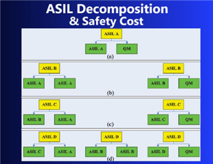

Jack,
We do have a device in the roadmap that would work as a safety element out of context for an ASIL-B system. In general designs, a system level ASIL-C requirement can be decomposed to an ASIL-B(C) and QM requirement like:
I can loop you in offline with the relevant roadmap details if it sounds good?
