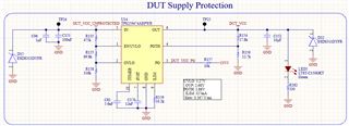

I see in the datasheet for the TPS25474 family that it is generally rated for 0.5A to 6V for its current limiting capabilities. Are these the firm limits of the device's capabilities?
I have this device in several locations for a PCBA where I generally follow this, but in a couple of locations I would like to limit the current below 500mA to something closer to 325mA. Is the device capable of limiting current at this level?
Attached is a schematic example of where I have not observed the device's ILIM set point rating:
I can likely correct this to be within the rated limits, but was curious if this is still a viable implementation. Are there any behaviors that TI recommends I look out for or any improvements to the implementation that TI suggests?
Also, I understand that it is a different device, but does any feedback given here also apply to the similar TPS25946 series as well?
    Higher than rated current can cause damage to FET. Lower currents i.e. below 0.5A won't cause any damage to FET. It is more of a current limiting accuracy of device limitation.
    The device wasn't made for that so will have worse accuracy (around 15-20% current limit accuracy). Also we don't test this in production nor do we have full validation data for <0.5A current limit. This 15%-20% number is from design team + small sample set validation across temp. TI won't guarantee this in the datasheet so I would recommend you to validate this at your end also.
    Nothing else other than above mentioned.
    Same story as TPS25947 as they are from same family so lot of common ip blocks.

  • Thank you for the clarification here. I will verify on my side about the current limiting range, but it is nice to know it is possible just with a wider tolerance. I appreciate the help here!
