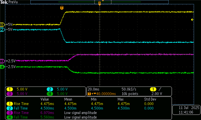

Hello Team,
We have requirement of +5V and -5V power supply for our design as per below specifications.
Input voltage = 12V-24V
Output voltage 1  = +5V 4A
Output voltage 2 = -5V 0.5A
We are planning to use LMQ61460AFSQRJRRQ1 for +5V and TPSM63603SRDHR for -5V (as both has same 5mS typical internal soft start)
Our question is, will both power supplies (+5V and -5V) ramp at same time as per the internal 5mS soft start circuit with different load conditions on each rail ?
for our application both supplies should ramp up simultaneously.
Do we need to implement any additional circuits to match the ramp time of both supplies?
