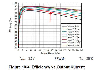

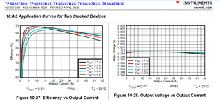

1. From below datasheet diagram, two stacked TPS6287B30 efficiency is only for output 0.8V, could you please provide two stacked TPS6287B30 efficiency curve for output 0.45V or 0.5V?

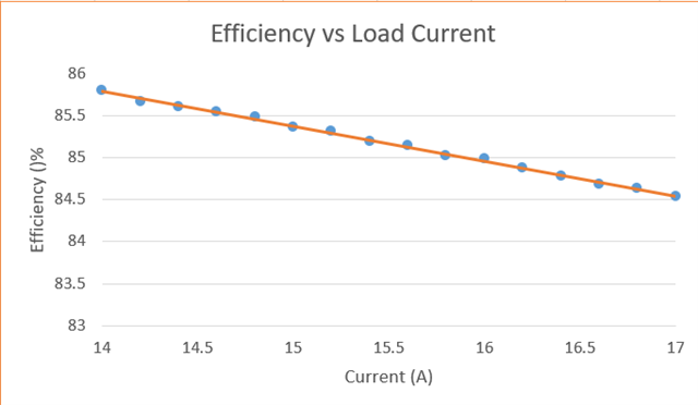

  • Hi Wenkang,
    Please find the results in the attached picture.
    Test condition: Vin=3.3V, Vout=0.5V, Iout=14~17A, room temperature.
    BR,
    Jingyi

    Oh I'm sorry. Looks like something went wrong.
    Can you see the attachment this time? The blue line is the data I got manually, and the orange line is the approximate efficiency.

  • Hi Jingyi,
    Yes. I have got your test data. Thanks for that.
    And from single device efficiency figure,I am not sure how much the efficiency of the two stacked devices improves compared to a single device at 15A load.
    In additonal, I guess the swtiching frequency is 1.5Mhz for both two stacked devices, am I right? How about the output voltage ripple?What inductor do you use for this test data?

  • Hi Wenkang,
    I'm deeply sorry that the previous efficiency curve is with a 2.5MHz switching frequency.
    Here is the efficiency results with 1.5MHz. Other working conditions remain the same. The inductor is the default one on our EVM, 744302010 Wurth Electronik.
    The output ripple is expected to decrease a bit compared to the single version, but not very significant.

  • Hi Jingyi,
    It doesn't matter. Thanks for your test data.It looks efficiency with 1.5Mhz is 2% more than 2.5Mhz's.

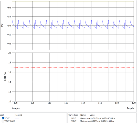

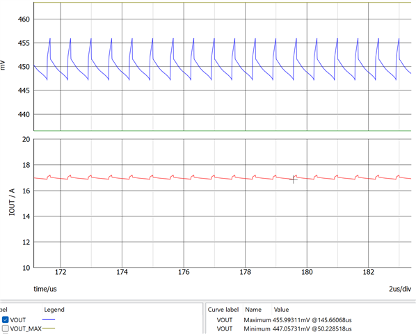

  • Hi Wenkang,
    Thanks. I will test it as soon as I get the inductor.
    For the ripple I can run simulations. The SIMPLIS model is used for simulation, with Vin=3.3V, Vout=0.45V, Iout=17A, Co=4x47uF+3x100uF.
    The Vout ripples are expected to be similar, as shown in the simulation results. It depends more on the Cout capacitance and ESR.
    Single:
    Two in stack:
