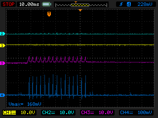

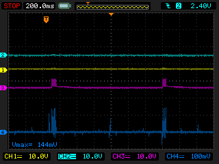

Below is the waveforms of the behavior: Channel 4 is connected to a current clamp that is monitoring the current flowing out of the battery. It's sensitivity is 10mV/A. Channel 3 is connected to BATDRV, Channel 2 is VAC, and Channel 1 is connected to the output.
The first waveforms are of the periodic current spikes observed. If the readings on channel 4 are to be believed, these spikes are up to 16A in magnitude.
The exact spacing between pulses is 3.2ms.

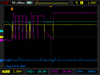

    In addition, we started looking for ways to maintain power supply even if the transition directly from charging to Hi-Z mode doesn't work. We found that we can configure the BQ25751 to transition to auto-reverse mode by enabling the EN_AUTO_REV bits, then monitor for the interrupt pulse triggered by the transition into reverse mode. Once we detect the transition into reverse mode, we set the EN_HIZ bit after a short time delay to force the device into Hi-Z mode. Doing this results in a successful transition into HI_Z mode even if under load.
    Here is an oscilloscope transition of the process.
    CH1 is the /INT pulse, CH2 is the voltage at VSYS CH3 is the voltage at the BATDRV test point, CH4 is the current out of the battery with a 10mV/A sensitivity. The time delay between the /int pulse and the setting of the EN_HIZ bit is 50ms. We still see some strange cycling behavior, however eventually it settles into Hi-Z mode.
