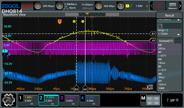

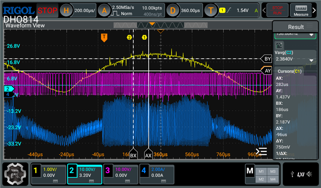

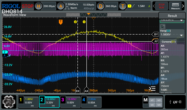

These images (different loads) show VINAC (yellow), COMP (cyan) - difficult to see against the pink, but value measured on the right, GDA (pink) and AC current (blue).
Here is a zoom-in on the transition.  You can see, just to the right of the cursors, that we get a short on-pulse on GDA and following this GDA and GDB run 100% in phase for the remainder of the cycle until the input voltage drops to the same level.  It isn't shown, but I monitored ZCDA and ZCDB around this point, and we get a normal pulse at the end of each on-pulse.

  • Hello Tom,
    This issue is caused by noise getting into the CS input.  Not spurious noise, I agree, but systematic noise.  Switching noise most likely.
    I presume that you shorted out the current sense resistor to avoid triggering cycle-by cycle CS overcurrent response, but it is happening anyway.  I also presume that you have an R-C filter network connecting Rcs to the CS input.
    On those presumptions, I suspect that switching noise is coupling into CS by going "around" the R-C filter, either by having amplitude high enough that the CS cap is not strong enough to filter it out, or that the CS cap is terminated to a point in the PGND that still contains some switching ripple current which "bounces" the CS signal above the PGND at the IC itself.
    The half-pulse width at GDA is due to both phases being shut off at the same time due to that noise pulse.
    Prior to that point the noise was there, but the peak amplitude at CS was not high enough to trigger the OC shutdown.  After that point, the noise was continually high enough to recurrently trigger OCP each cycle.  Both phases restart in-phase in the next cycle after an OCP shutdown and would move apart to ~180 in a few cycles, except that the noise retriggers OCP again.
    This continues until the line voltage drops low enough that the noise also drops low enough to stop retriggering OCP.
    I recommend that your CS filter cap should be connected to the CS and GND pins of the UCC28064A as closely as possible, and the R of the R-C filter also be close to the CS input to minimized opportunity for noise to couple to the CS node.
    If this is already done, then experience has shown that only a larger value of filter cap will squelch the noise.
    An RC filter adds a time delay to peak current detection.  So a larger cap with the same R will delay longer, allowing higher peaks before being triggered.  If a larger cap solves your noise problem, you may experiment with using a slightly higher Rcs value to restore the lower peak level for triggering OCP.
