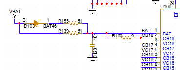

I'm using BQ79718VPAPRQ1
Due to system requirements, I need to add a diode on the BAT input:
In addition, I made the following short between the last cell (cell 15) and VBAT:
Is that OK to add the serial diode as shown above?
Thank you,
Raya.
  • Hi Raya,
    1,What is the purpose of adding this diode?Normally, you don't need to add this diode. If you really want to add this diode, I don't think it will affect the normal use of the system.
    2,For unused channels, shorting them all to BAT is the recommended method in our data sheet.
    thanks
